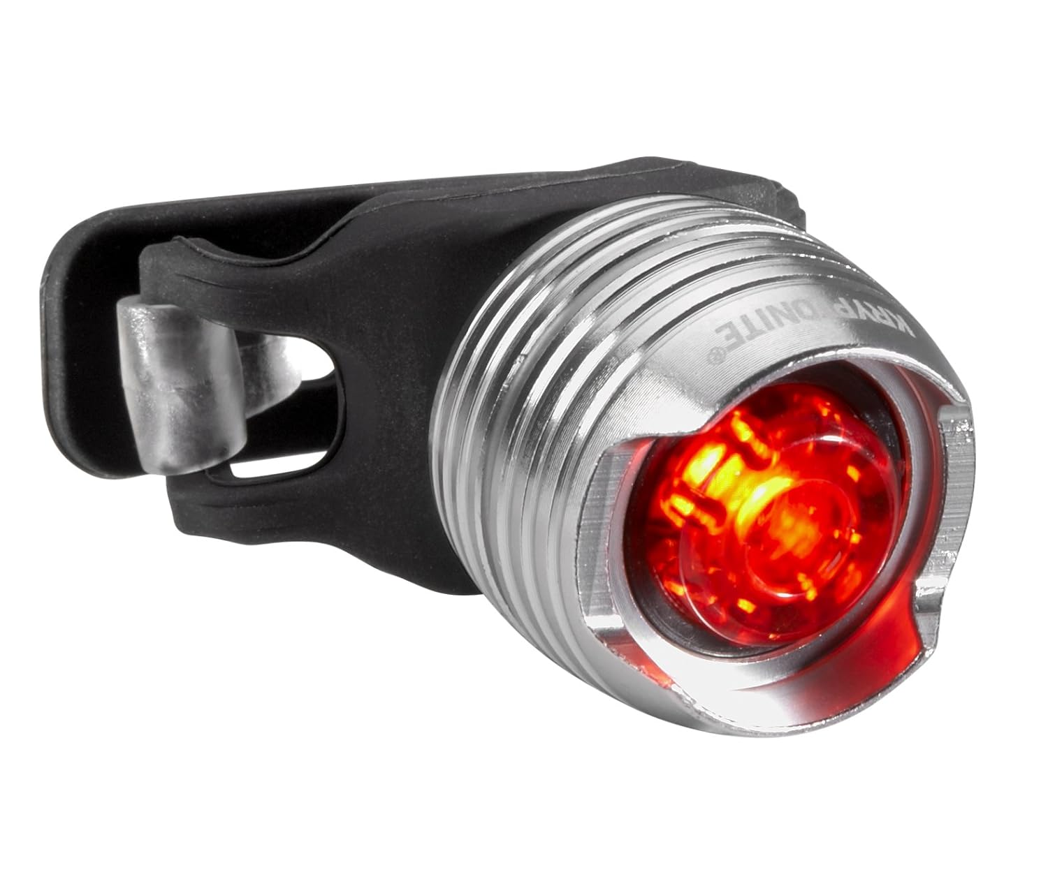

  18. Negativ3
    Negativ3 Silver
    Agree with the others, beautiful work.
    Has the bike got a rear light?
  19. Robert
    Robert Silver
    Thank you and Yes! These rear lights are awesome:
