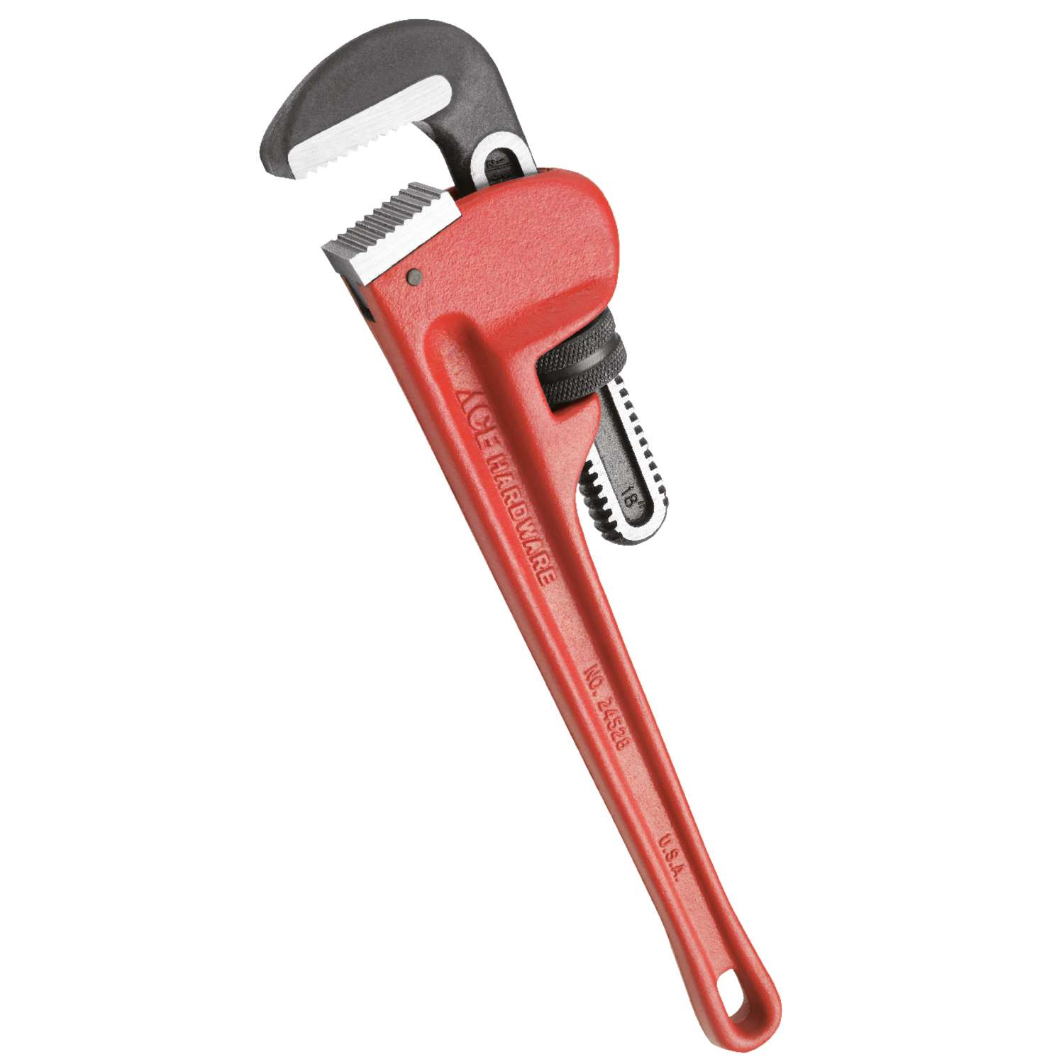

  7. HT1
    HT1 Gold Banner Member
    that cracking looks like a design issue, thin the inner web and make the transition smoother, this image gets you an Idea of the cross-section your looking for , there are some very specific references for the size of fillets, sadly I cannot find one in my reference materials
    when I have to do something in an I beam shape, this is my go to example , that's right a pipe wrench , good on the eye, good in the hand , take I look at one it is actually a more complex shape then it ppears at first glance
    V/r HT1
    P.S. round things off well, I know that in CAD and 3D work, straights and squares are easier, but in casting it is worth the extra time on the pattern to make things more... "organic" then make many copies from the pattern.
    And well done !!!

    I think the first plan of attack will be to thin that web. It is far more massive than it needs to be, nearly 7/8" thick and the cracks are present in varying degrees over the whole length of the arm. I am also going to incorporate the dovetailed mount insert right onto the arm pattern instead a casting it separately and bolting it onto the arm as I've done here. (It happens that the everdur material I just bought from Lou consists of 5/16-18 bolts so I got off my purist high-horse and used them instead of making them from raw material). But in any event, those bolts become the weak link so I'll cast that part already joined to the arm. This will set up some different feeder requirements anyway, but I'll keep your suggestion in the toolbox! Thanks.
