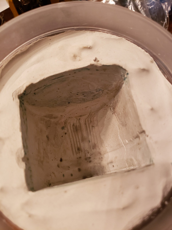

  1. Any tips casting this piece. Original toy was zinc, about the size of a tennis ball. I have made a 2 piece plaster mold but am concerned about the flow of metal. I was playing around with lead and it dries fast.

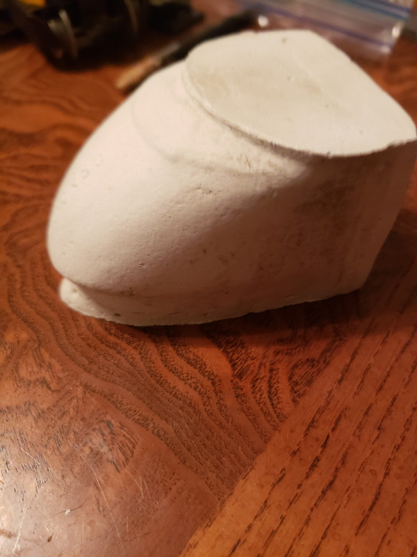

  5. Here is the plaster mold I made.
  6. Jason
    Jason Gold
    GOOD! Now soak BOTH pieces of plaster for 20mins. Shake and pat dry with a paper towel, and pour wax into the gap. Then you will have your wax positive. Invest that into a flask filled with ultravest after you add sprues. Dewax, burnout, and pour metal. Break it apart and out comes your part.

  13. So this is my first attempt. Where did I go wrong. Some of the zinc is shiny other sections are rough. It was one pour. Any tips?

  14. dtsh
    dtsh Silver
    I'm guessing steam from the mold, but my experience with casting into plaster was only couple of times about 40 years ago. My success rate then was zero, unless you count steam explosions in which case it was significantly higher. (I had almost no idea what I was doing)
    What was your dryout process?
  15. I let it air dry for 2 weeks. I didnt see steam when I poured the metal.
  16. dtsh
    dtsh Silver
    IMO, you won't see steam, at that point it'll be a steam explosion and it will spit molten metal back at you...at least that was my experience.
    Some time in the oven to drive off extra moisture is my guess. Sorry, but no help on details, I abandoned the process before getting it to work well.
  17. Billy Elmore
    Billy Elmore Silver
    Try adding some vents to the mold and I think it will help immensely. Anywhere you see a shiny spot on these castings is where you trapped gas so try and put them there.
  18. rocco
    rocco Silver
    My guess is that's not good enough and a small amount of steam was created which may have caused the defects. Check the Wikipedia article on plaster to gain an understanding of the role water play in the chemistry of plaster.
    The following comes from Georgia Pacific's metal casting plaster page, GP Metal Casting Plaster
  19. doubt shiny is from steam. The slug in my ladle is shiny because the surface is smooth.
  20. Billy Elmore
    Billy Elmore Silver
    Looks like it was cold.
