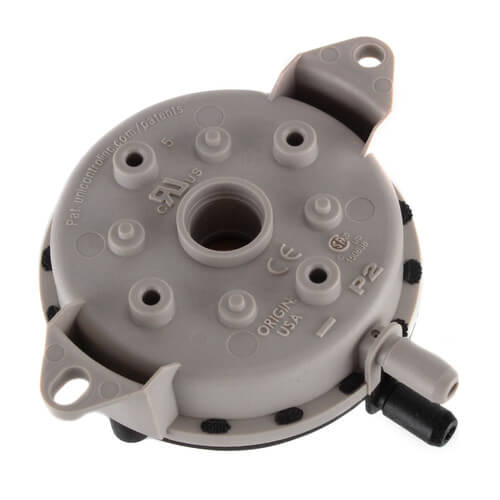

    search "sail switch" they can be set up to shut off the gas if you loose sufficient air flow , you have to wire them with a bypass so you can start the burner

  14. rocco
    rocco Silver
    That looks like a very simple set-up, it would fairly easy to repurpose this type of simple micro limit switch to do that.

  15. Fasted58
    Fasted58 Silver
    Thanks guys. I'll take a look at sail switches and how to adjust and mount them.
    Looking at this type currently for ease of install:
    Robertshaw, comes with several springs for range and is adjustable as well.
    Ordered a digital manometer to bench test the burner first, then to order a switch in range. Since I retired I cannot borrow the 'cool tools' from work anymore. Likely will have to tune the switch in the furnace. 24VAC and 110VAC gas rated solenoid valves are relatively cheap also. Don't mind spending time and money on projects like these, it's way cheaper than my old hobbies like building project vehicles.
