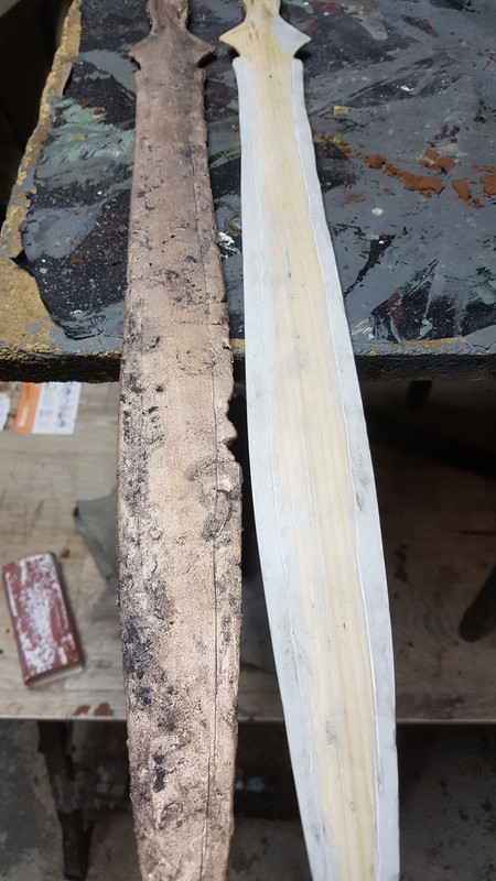

    Hi all,
    after having some success casting some smaller replica bronze artefacts such as axes and a handful of short swords of around 30cm (only a few months new to this hobby), I have run into a couple of problems when attempting to cast regular sized bronze swords. Basically, I just can't seem to get proper edges on them. I have had success with two or so blades, however the rest have all been defective. I can't put my finger on what exactly I am doing wrong: pour rate is slow and even, the bronze i'm using is nice quality, and I can't see any problem with the mould making technique: basically identical to how Will Lord shows in his video here
    Sand: Petrobond. Vertical pour.
    Have tried both angling the mould slightly and while it does provide a slightly better finish, it does not help the problem with losing some of the edges.
    My patterns are made of wood and the thinnest part of the edges are around 1mm- I deliberately made the patterns thicker on the edges to try and avoid the very problem I am having! However, most people I see casting swords use an actual sword as their pattern which would obviously have been sharpened and have very thin edges. So I'm not sure if the pattern is my problem or not.
    Here is the sort of problem I'm having: As I say, the very odd time I do get a nice cast but really feel like I should be having a higher rate of success than currently.
    One of my (very bad) castings with the pattern on the right:
    If anyone has any experience in this area, I'd love to hear from you.
    Thanks!
  2. Judging by your photos, the bronze needs to be hotter, I wouldn't pour something that length vertically as the hydraulic head will try to extrude the liquid bronze into the petrobond to some extent. You may get away with it at lower bronze temperatures to some extent but it will be an issue. The only bronze swords I've helped pour were quite thick so we were able to pour horizontally from the handle end and there was minimal shrink in the middle of the sprue. For something thinner you'd likely need runners or cast a much thicker blade and thin with stock removal to get to final shape. I've noticed bronze casting in general is sensitive to metal temperature: just moving from an A20 to a smaller A16 crucible size meant running at a higher temperature and having to pour fast to minimize cooling. The bronze swords pictured below are about 20mm thick/ 0.8" at their thickest point and can be barely lifted let alone swung due to their weight. The owner was going to spend a lot of time grinding down to size and they were going to be some kind of ritual temple sword/ornament.

  3. HT1
    HT1 Gold Banner Member
    your metal is terrible! you can see all sorts of dross (Bi metal) related issues probably from the very long fall of the metal,
    the only way to overcome that in a vertical pour is to get the metal in extremely quickly so all the dross floats to the top into the Gating system (basically a riser)
    I'm just going to assume you are starting with good clean metal properly skimmed, if that is not true, fix that first,
    I assume you know Bronze swords are forged, work hardening in the process, so your thick edge is normal, after casting the blade would be hammered to a finished edge COLD, which will work harden it ,
    If you cannot get a better finish pouring vertically, you will have to pour horizontally, for the very best finish you would want the part of the sword farthest away from where the metal enters raised 15 degrees, this will allow the blade to fill very gently, not creating any bimetalfilms , if the metal flows down hill there will be turbulence, creating dross,
    Actually the very best way to fill this is pretty much a no go for the hobbiest you would need a vertical pour but a sprue going all the way to the bottom, so it fills up gradually from bottom to top, yes your metal would need to be at the top end of it's pouring range , this very long sprue would have to be quite small at the choke point .
    V/r HT1
    P.S. from your pictures, it looks like you are pouring dross into your casting , are you skimming the metal before pouring?

  4. metallab
    metallab Silver
    This indeed appears to be a too cold pour. As HT1 mentions, vertical castings that long tend to cause much hydraulic pressure on the end of the sword. Bronze is almost 8 times as heavy as water, so the hydraulic pressure is 8 times as much as a water column that length. A good idea is what he says: make a long sprue towards the very end and let it fill the mold upward. That also mitigates the chance of slag / dross inclusions.

  5. Conor
    Conor Lead
    Thanks- so just leave the metal in the furnace that bit longer? I try to add a small little sprue at the tip of every sword for this reason, but maybe I need to make it longer. Thanks.
  6. Conor
    Conor Lead
    Thanks for the reply. I generally flux with a pinch of borax first- and once I remove the crucible before casting I skim with a spoon. But generally there seems to be very little dross on the top- indeed I remember this casting hadnt really any so I didn't bother skimming.
    So you think maybe a quicker pour may help?
  7. HT1
    If I implied that it was not my intention,
    we are getting seriously deep into the weeds
    Go read this entire thread: http://forums.thehomefoundry.org/index.php?threads/bob-puhakka-on-bifilm-theory.621/
    digest it slowly, ITS VERY ADVANCED!!!
    in simple terms you need to get the metal into the mold as quickly as possible without agitating it . those two thing fight each other, they are close to antithetic, but not quite
    here is an example, not a great one, but an example , you have a casting getting filled from the bottom, now picture the casting is 3 foot long but quite thin, so we raise the right hand end up 15 degrees (Mold manipulation) so the entire casting fills without creating any Bifilms , as soon as you see metal in the riser at the bitter, upper end of the casting, pour metal into it , this will add lots of heat to the coldest metal (BTW if you are going to do this insert that riser at 15degrees so it is straight up and down as poured)
    Now that said the gating system, particularly the Choke becomes critical if it is too small metal will spray into the mold, picking up tons of dross, if it is too large, you will not be able to pour fast enough to keep the gating system full and it will "gulp" air also creating tons of dross, this gating system has to be quite small at least at the choke.
    I believe in the thread above I mentioned that as a general rule hobbiests are using far too large of sprues ( the base of the sprue is often your choke) i cannot see many hobbyists needing anything larger then a 1/2 inch sprue.
    Horn gates have a tendency to cause turbulance because of their shape , but mostly because the choke end is too large.
