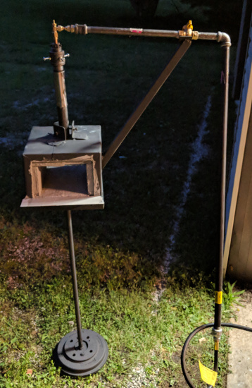

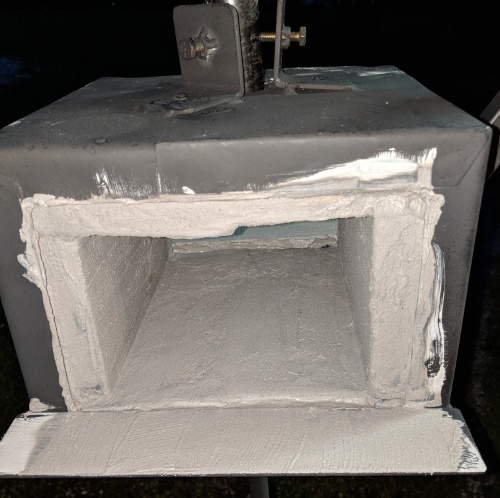

    This weekend was kinda of rainy here so I didn't get to test this thing but I did get the piping installed and some Satanite applied to the inside.
    I ran some 1/2" hard line up to the burner because I'm worried the heat from the forge may not do well with the rubber line.
    I was not very careful applying the Satanite. It goes with the quick and dirty feel of this forge.
    Hopefully I can get it cured and the burner tested one night this week. I might add another layer of Satanite but I want to see how this goes first.

    Fire that sucker up, you can add Satanite later if you want. It's on brick anyway.

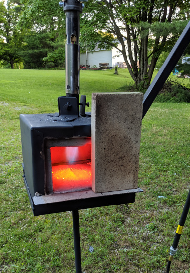

    So I leak tested everything last night... There was an issue with the one connection that I had in there due to the only needle valve I could find had a 1/4" npt on one side and 1/4" OD on the other.... Well after the leak and a trip two 2 different local hardwares (one closed @ 6). I found a 1/4"npt valve and got no more leaks! I couldn't stop there so I fired it up!
    Until it heated up I had an issue with the burner sputtering like a pulse jet. With a few adjustments to pressure, flow, and air I got her settled down.
    I was able to get the two brackets about 90% down in about 2 Hours. Being able to control the location of the heat really sped the shaping up. Those blacksmith guys might be on to something :)

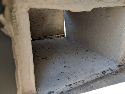

    After running the forge for a few hours I shutdown and let it cool outside over night. After that the Satanite seems to have held up well. there's one small crack down the middle where the seam between the bricks are.
    I'm not sure that this little forge will get up to forge welding temps but it will get hot! I had to keep an eye on the steel in there. I was used to using the furnace before, so last night I ran in to the house to pee while the steel was heating and it was almost too hot when I got back just a couple of minutes later (I didn't even get sidetracked on the way back like normal :eek: )

    Looks great! Also looks like you should have no trouble getting to welding temperature. At worst put another brick in front leaving just enough room for your tongs and the work. Do you have experience forge welding?

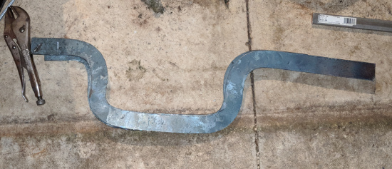

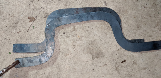

    The rain went away for the evening and I was able to tweak the brackets into a "Close Enough" state. I'm going to end up tacking them together and Grinding the side the back is going to weld to just to make sure it sits flat and lines up 100% (ok I'll take 92% if it comes to it).

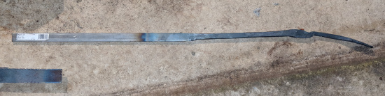

    Then I felt froggy and started smacking some metal into a tong like shape. I stopped beating about 10 PM because I try not to bug all my neighbors too much. I got about 50% of one side "rough forged".
    I really don't "know" what I'm doing. I've done some research and watched a couple of YouTube videos. So I started with isolating the rivet boss. Then worked on drawing out the jaws. Twisted the last 2" perpendicular to the flat of the bar. Then I started drawing out the handle. I know I did it backwards I started from the Rivet boss and moved back. I did this for 2 reasons. 1 I have no clue how much material I'm going to need (I want to use these to drop charges into my furnace too so longer is better). 2nd I don't have tongs so I can't grab glowing metal and I just forged the jaws...their stupid hot!!. Knowing this I'm keeping things thicker than I think they need to be till I get a rough length . then I'll cut the extra off and forge the small end up to the big end. I know that the jaw is sorta a mess, I'm hoping that I can learn a little by beating the handle in place then I'll be able to fix the jaw....or I have a grinder :D. I was surprised how much I could get the steel to move when it was properly hot with just a 3# hammer. I didn't have to beat it, just lift the hammer and let gravity do most of the work. The few times I did wack it early on I almost over did it as it moved too much. Hopefully the rain stays away and I can get some more done tonight, It's hot enough around that forge in the evening when it's been 75-80 out now they are calling for 90+ degrees F I don't want to fire it up during the day if I don't have to!!. Let me know if I'm doing something totally wrong or I've screwed something up so bad I can't fix it!

    Looks good to me. Make the second one before you go too far. Put a bolt in and you can make them match while both are hot, but use a rivet on the finished tongs. There's just no substitute for experience. You'll like your second set of tongs better, but I'm still using my first set.
