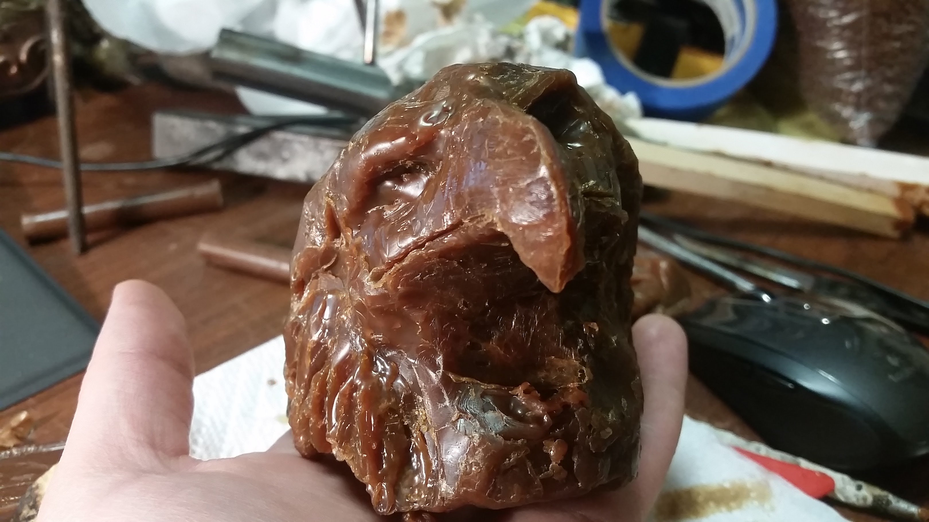

    I decided to make an eagle last year late august. Originally it was just going to be an eagle head fo a walking cane, but then I made the head too big and decided to make a body for the head. So this project sort of morphed out of nowhere into a pretty elaborate project that will require multipart silicone rubber molds and hollow casting using lost wax. This thread is a copy of all my photos, I will update this thread going forwards. The original thread is here: http://www.alloyavenue.com/vb/showthread.php?12418-Eagle-Statue&highlight=eagle
    I finished the general details on the left side of the head. Some ruffled feathers.

    This is the wax I am using
    I was experimenting with body shapes for the bird here, ultimately decided to go with a sitting quizzical pose rather than the overdone swooping down killing things pose.
    I'm trying to show things sequentially and from the same angle each time to give you an idea of how I'm doing it.
    I got some legs on it today.
    I think I'm going to angle the head so it looks down more. It is currently looking way too far up which I think is an unnatural position for their heads to be in. They never look up at you, they always look down on you. That position will work better if I mount it high up near the ceiling inside our house. So it peers at you out of reach like the little sky-cat that it is.
    New head position. Moved it more forwards and more tilted to the side (the photo on the right). What do you think? A smidge better? I also slimmed down the neck. I need to do a lot of detail work now but the body and proportions are basically correct.
    Before : After
    Far right picture has the most up to date bird.
    Almost done with one wing. Got a bit of blending to do around the head/wing junction and then add some detail to the long feathers, then its on to the 2nd wing, stomach and feet. Progress is pretty slow. I get about a 2x2" patch done over the course of about 2 hours.
